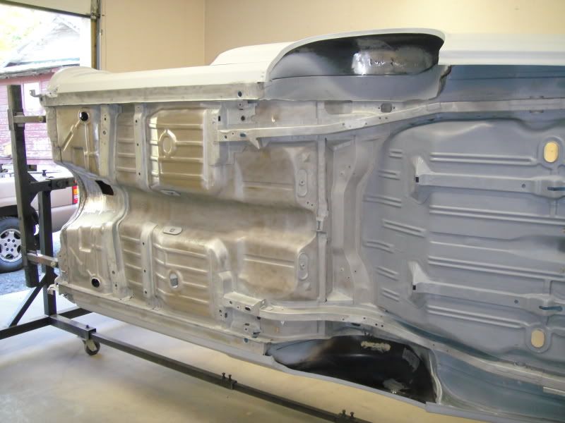

jasonL78 10-10-2011 02:57 AM
Re: My new 1968 Nova L79 project.
Moving forward with the restoration. I have the rearend all rebuilt and detailed. The L79 is at the machine shop. The transmission should be back at the end of the week.I just got the car onto the rotisserie and media blasted the bottom today. I also had time to put some black epoxy and high build primer on it. Time to start sanding.
http://i35.photobucket.com/albums/d1...-11-L79009.jpg
http://i35.photobucket.com/albums/d1...1-L79005-1.jpg
http://i35.photobucket.com/albums/d1...tomside002.jpg
http://i35.photobucket.com/albums/d1...tomside004.jpg
http://i35.photobucket.com/albums/d1...tomside005.jpg
http://i35.photobucket.com/albums/d1...tomside006.jpg

markjohnson 10-10-2011 03:57 AM
That 12-Bolt rear axle housing just looks frickin' unbelievable! No pits or anything. How'd you get that metal so smooth?
jasonL78 10-10-2011 01:01 PM
Actually the rear-end housing only had some very light pitting. The car was from Louisiana so it really never seen the harsh environments. Just a couple of coats of high build a small amount of filler and you end up with a very nice housing. It is all about how much time you put into it.

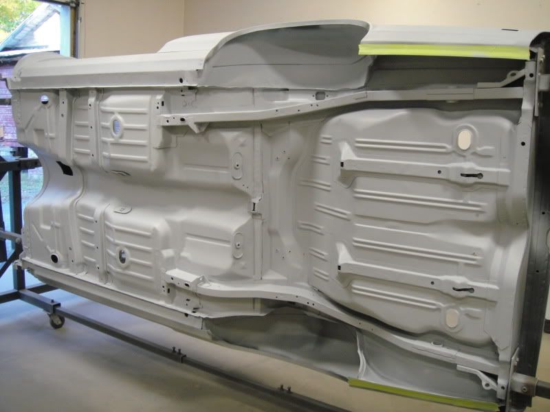

jasonL78 12-05-2011 01:05 AM
Finally got the bottom side all painted with the top coat. I just have to fade some blue over spray.
I am moving onto the sub-frame next. So when I get my motor back the sub-frame will be all ready for the motor and transmission.
http://i35.photobucket.com/albums/d1...nchale/005.jpg
http://i35.photobucket.com/albums/d1...nchale/009.jpg
